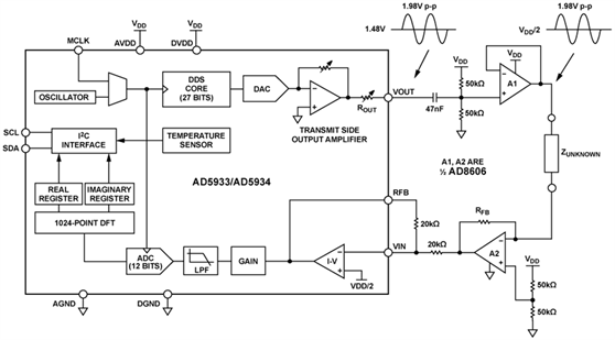

The AD5933AD5933 and AD5934AD5934 are high precision impedance converter system solutions that combine an on-chip programmable frequency generator with a 12-bit, 1 MSPS (AD5933) or 250 kSPS (AD5934) analog-to-digital converter (ADC). The tunable frequency generator allows an external complex impedance to be excited with a known frequency.
The AD5933AD5933 is a high precision impedance converter system solution that combines an on-board frequency generator with a 12-bit, 1 MSPS, analog-to-digital converter (ADC). The frequency generator allows an external complex impedance to be excited with a known frequency. The response signal from the impedance is sampled by the on-board ADC and a discrete Fourier transform (DFT) is processed by an on-board DSP engine. The DFT algorithm returns a real (R) and imaginary (I) data-word at each output frequency.
The AD5934AD5934 is a high precision impedance converter system solution that combines an on-board frequency generator with a 12-bit, 250 kSPS, analog-to-digital converter (ADC). The frequency generator allows an external complex impedance to be excited with a known frequency. The response signal from the impedance is sampled by the on-board ADC and a discrete Fourier transform (DFT) is processed by an on-board DSP engine. The DFT algorithm returns a real (R) and imaginary (I) data-word at each output frequency.
The circuit yields accurate impedance measurements extending from the low ohm range to several hundred kΩ and also optimizes the overall accuracy of the AD5933/AD5934.

Key Features for AD5933AD5933:
  • Programmable output peak-to-peak excitation voltage to a maximum frequency of 100 kHz
  • Programmable frequency sweep capability with serial I2C interface
  • Frequency resolution of 27 bits (<0.1 Hz)
  • Impedance measurement range from 1 kΩ to 10 MΩ
  • Capable of measuring of 100 Ω to 1 kΩ with additional circuitry
  • Internal temperature sensor (±2°C)
  • Internal system clock option
  • Phase measurement capability
  • System accuracy of 0.5%
  • 2.7 V to 5.5 V power supply operation
Key Features for AD5934AD5934:
  • Capable of measuring 100 Ω to 1 kΩ with additional circuitry
