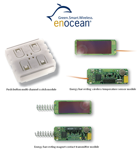

EnOcean Sensor Kit features a set of three wireless sensors; Push Button, Reed Switch & Temperature Sensor.

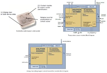

Push Button Sensor: The PTM 210 is a miniaturized batteryless switch module (40 mm x 40 mm x 11.2 mm) which allows the realization of very slim on-wall mountable rocker switches or remote controls. The actuating force is around 7 N only over a travel of 1.8 mm. Optionally, one or two switch rockers or up to four push buttons can be realized.
Temperature Sensor: Energy harvesting wireless temperature sensor module (STM 330) with an extremely low power RF transmitter module optimized for realization of wireless and maintenance free temperature sensors. Can also be used for room control panels including set point dial and occupancy button with the addition of a minimum number of external components. The module provides an integrated calibrated temperature sensor. STM 330 also supports the plug-in humidity sensor module HSM 100.
Reed Switch Sensor: Magnet contact transmitter module (STM 320), extremely low power RF transmitter module enables the realization of wireless magnetic contact sensor. Powered by a solar cell, completely maintenance-free.
