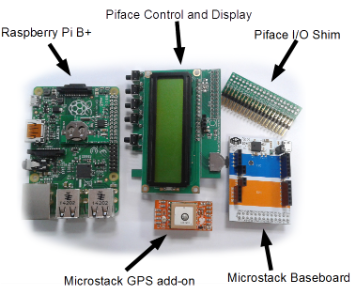

I recently got a microstack GPSmicrostack GPS and base boardbase board, and I was initially struggling to think of a good fun project to do with it until I went walking across the tops of my local moors and thought, geocaching would be really cool and far easier to do with a bit of tech helping you out.
The current problem is that to go geocaching you either need to be good at reading OS maps accurately and have the right map for the area, or have an expensive GPS system, even the cheapest of gps systems cost more than £80.
Would the raspberry pi and the new Microstack GPS module and a display bring that down to less than £80 and then you have the freedom to disassemble it and use it as something else when you're at home and no geocaching (the other 364 days of the year).
Everything I am using:
Raspberry Pi Module B+Raspberry Pi Module B+
Microstack BaseboardMicrostack Baseboard
Microstack GPSMicrostack GPS
Piface I/O SHIMPiface I/O SHIM
Piface Control and DisplayPiface Control and Display
(if you need to buy a pi then it is cheaper to buy a Raspberry Pi ARaspberry Pi A  for this project (fewer USB ports and no ethernet are the main differences) but I only have a B and a B+ so I used my B+.
Let me set the scene a bit better. In my spare time I am both a scout leader and a cub leader, and when we go to camp we often set up some sort of temporary geocaching route. However where we go we often do not have enough maps for all the teams to have one so we usually do the geocaching using  distances and keep the caches fairly close together and give them a compass. However if a group gets lost they have no map and so the leader  that is following them has to put them right again. So to get rid of these problems, a GPS system that gives them a distance from their current position, would be great and mean that they couldn't get lost as it would always give them the directions from their current position.
The basic Idea
So my idea for the project is to use the GPS module to get their location, read the list of geocaches on the Pi, choose the nearest cache automatically, then display the distance on the screen.
Simple, in theory.
