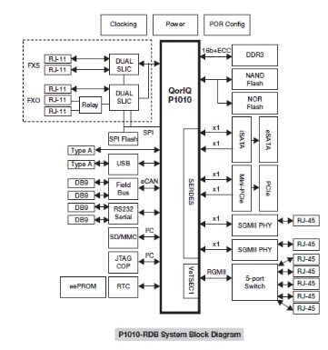

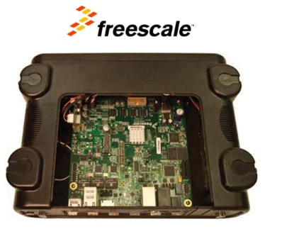

Freescale’s P1010-RDB is a highly integrated reference design board that can help shorten your time to market. The reference design is aimed at low-cost networking applications (with or without trust architecture), wired and wireless access, as well as industrial and smart energy applications.
This cost-effective board is based on the QorIQ P1010 processor family along with leading-edge external components to help you quickly design and implement your target application. The P1010-RDB leverages the P1010 processor and supports both the full-featured P1010 as well as the more costefficient P1014 device.
The P1010 processor family is based on the e500 core, built on Power ArchitectureRegistered technology, which has a core frequency range of 533–800 MHz, and supports a 32 KB instruction and L1 data cache and a 256 KB L2 cache. The P1010 also supports a complete trust architecture environment, CAN controllers for industrial applications, three Gigabit Ethernet controllers with IEEERegistered 1588 v2 support, USB 2.0 plus PHY, two PCI ExpressRegistered 1.0a controllers, up to six SerDes interfaces, 16/32-bit DDR3 and DDR3L (16-bit mode supports ECC), SPI controller supporting booting from SPI, serial flash memory, SD/MMC card controller supporting booting from flash cards and an integrated security engine. The new P1010 family with, built in 45 nm process technology provides high integration for cost-efficient solutions and enables a trust platform (through trust architecture) for customers that want to preserve the hardware or software integrity of their platforms.

Kit Features
  • Memory
    • 1 GB DDR3 (8-bit x 4 chips), supports up to 8 GB on-board DDR3 SDRAM
    • 32 MB (16-bit) NOR flash memory
    • 32 MB SLC NAND flash memory
    • 256 KB I2C EEPROM
    • 128 MB SPI Flash
    • SD/MMC connector to interface with the SD memory card
  • PCI Express
    • One standard PCI Express connector
    • One mini PCI Express connector SATA
    • One internal SATA connected to 2.5” 160G
  • SATA 2 HDD
    • One eSATA connector to rear panel USB 2.0
    • One USB 2.0 port connected via UTMI PHY to mini AB interface
    • One USB 2.0 port directly connected to mini AB interface
  • Three 10/100/1000 Ports
    • eTSEC 1 connected to RGMII PHY
    • eTSEC 2 and 3 connected to SGMII PHY
  • Flex CAN
    • Two connectors for field bus interface
  • UART
    • DUART interface, terminated as RJ45 connectors
  • TDM
    • Two FXS ports connected via na external SLIC to the TDM interface
    • One FXO port connected via a relay to FXS for switchover to POT
  • Others
    • LEDs: Power (green), link (green), activities (yellow)
    • JTAG for debugging
    • IEEE 1588 v2 signals for test and measurement
  • Form Factor
    • Mini ITX form factor

Kit Contents
P1010-RDB Board Only
