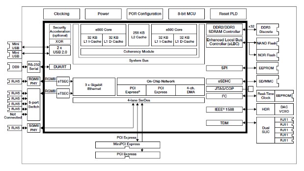

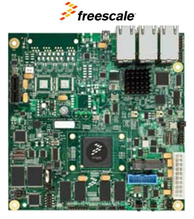

Freescale’s P1020RDB is a highly integrated reference design board that can help shorten your time to market. The reference design is aimed at networking, wired and wireless access, industrial and medical applications. This cost-effective board is based on the QorIQ P1020 processor family, along with leading-edge external components to help you quickly design and implement your target application.
The P1020RDB leverages the P1020 processor and supports both the dual-core P1020 and single-core P1011 configurations. The P1020 processor family is based on the e500 core, built on Power Architecture technology, which has a core frequency range of 533–800 MHz, and supports a 32 KB instruction and L1 data cache and a shared 256 KB frontside cache. The P1020 also supports three Gigabit Ethernet controllers with IEEERegistered 1588 v2 support, USB 2.0, up to two PCI ExpressRegistered 1.0a controllers, up to two SGMII SerDes interfaces, 32-bit DDR2/3 with ECC, SPI controller supporting booting from SPI serial flash memory, SD/MMC card controller supporting booting from flash cards and an integrated security engine. The new P1020 family, built in 45 nm process technology, provides high integration that simplifies board design and offers a cost-effective solution.
Key Applications: Connectivity( EtherCAT, IEEERegistered 1588) , Industrial (Programmable Logic Control (PLC), Fieldbus-to-Ethernet Gateway, Gateway (Router), Ethernet Switch), Networking, Single Board Computer(Unified Threat Management (UTM) Security Appliances, Multi-Service Business Gateway, Wireless LAN Access Point)

Kit Features
  • Memory
    • 512 MB DDR2
    • 16 MB (128 MB device) NOR flash memory
    • 32 MB NAND flash memory
    • 16 MB SPI ROM
  • PCI Express Interconnects
    • One standard PCI Express connector (x1)
    • One mini PCI Express connector (x1)
  • Ethernet
  • Six 10/100/1000 ports as follows:
    • Four ports from L2 switch connected
    • to eTSEC1
    • One SGMII PHY connected to eTSEC2
    • One RGMII PHY connected to eTSEC3
  • IEEE 1588 v2
    • Clock input from DAC/VCXO circuitry
    • Accessible via test header
    • System Integration
    • Dual I2C
    • SD/MMC card slot
    • Dual USB
  • Mini AB connectors on I/O panel (default)
    • UARTs
  • One DB9 connector
    • Dual SLIC for FXS/FXO interfaces
  • Mini-ITX Form Factor
    • 170 mm x 170 mm
    • 6-layer PCB routing (4-layer signals,2-layer power and ground)
  • Lead-Free (ROHS), CE and FCC Certification
