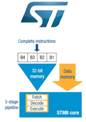

The STM8 has a high energy-efficient architecture, based on a Harvard architecture and pipelined execution. A 32-bit wide program memory bus allows most of the instructions to be fetched in 1 CPU cycle. Moreover, as the average instruction length is 2 bytes, this allows for a reduction in the power consumption by only accessing the program memory half of the time, on average. The pipelined execution allowed the execution time to be minimized, ensuring high system performance, when needed, together with the possibility to reduce the overall energy consumption, by using different power saving operating modes. Power-saving can be managed under program control by placing the device in SLOW, WAIT, SLOW-WAIT, ACTIVE-HALT or HALT mode.

  • Harvard architecture
  • 16‑bit index registers and stack pointer
  • 32‑bit memory interface and 3‑stage pipeline
