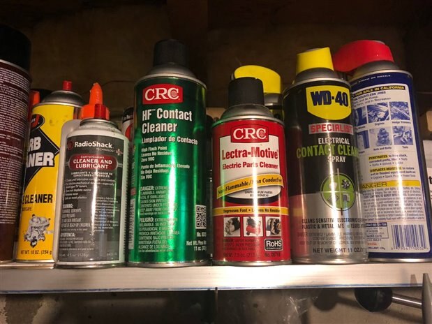

    korn over 8 years ago
    for guitar amps I like to use a cleaner that clearly states "leaves no residue" to flood the switches and controls.
    then work them out, clicking or turning many times..
    then give a second wash and a blast of compressed air before  I go back and carefully hit each switch with a cleaner that says "lubricant"
    here are my favorites...
