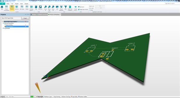

Laying out a simple circuit, 2 LEDs, 1 resistor and power contacts was quite easy. I started in a schematic design window. I laid out the parts as simply as possible. I used the generic component, which will only place a footprint for the parts. Standard is through-hole components. Using the Altium component vault, I could have grabbed specific parts.
Next, I “compiled” the schematic. This will allow me to import the schematic as components in the PCB layout window. I did just that. I then placed the parts on the board. (Which, I re-shapped to look like a bow-tie. This wasn’t intended, as I was seeing how the “board shape” options work. So, I went with it.)
After placing the components, I used the manual route option. Which I simply connected the dots. There is an auto-trace option too, but, for this simple design, I didn’t this is was necessary. I checked for errors using the “Design Rule Check” button, found none. It is done!
I switched to the “3D view” from the view tab. There you go. A design in less than 3 minutes.
