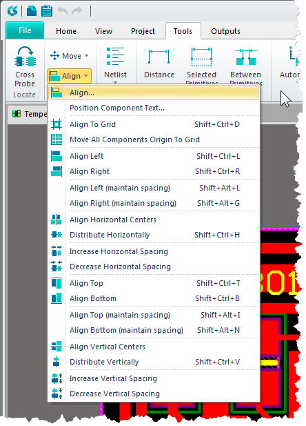

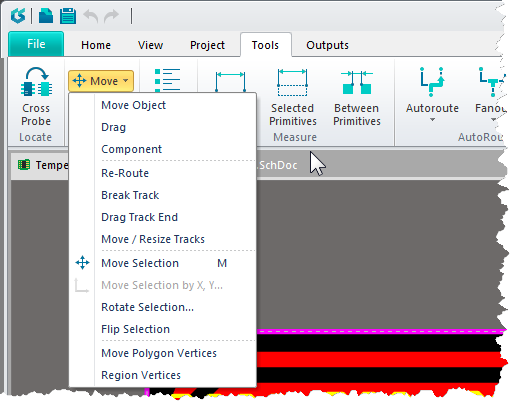

Some useful tools in CircuitStudio are the move and align commands. These are a little bit hidden away on the Tools tab so you may not yet have noticed them.
