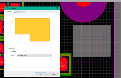

    If you want a rectangular "hole" then make this as a Board Cutout on the Home tab of the menu.  Draw what you want on the Outline layer, select the closed shape and press the Board Cutout button.
    Ex in 2D view and 3D view
    Some warnings:
    After making the cutout, you can select and move the cutout around so be careful to lock it down so you don't move it by accident (see above picture).
    Make sure you review the CAM files before placing your order to be sure the cutout was properly generated.
    [Edit-added] Make sure to pull-back any copper from the cutout edges with a keepout or other means; especially on inner layers.

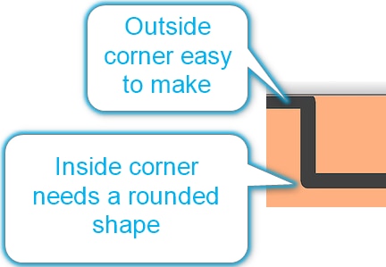

    You can search the web for "PCB rectangular cutout" and get some information about fabrication limitations.
    When making a PCB board shape that is not a simple rectangle, inside corners should have a reasonable radius that can be fabricated.
