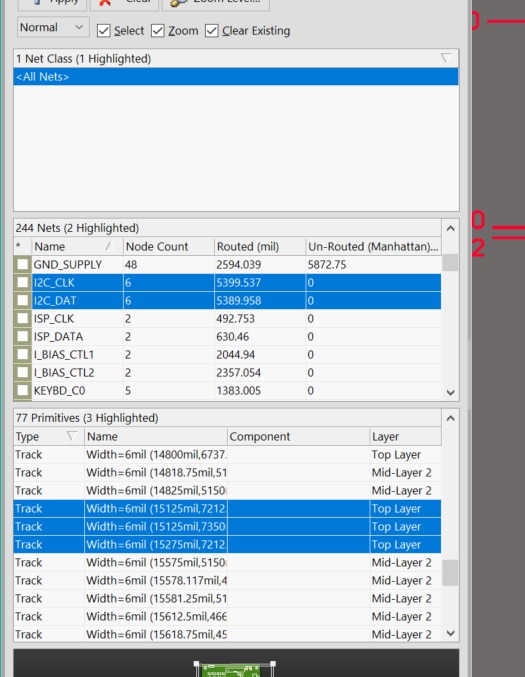

I've been working with circuit studio for a board design, and I haven't been able to figure out how to change settings on a group at a time. for example, if I decided after routing a few traces that I wanted to change their width, that I could only select a single segment of a single net at a time. I also want to know how to change the settings, like tenting or size, for all vias after they're placed. as it stands, I only know how to change each via individually.

    I think that is described here at the link below:
    To change multiple selected objects with common properties:
    PCB Inspector | Online Documentation for Altium Products
    To select objects:
    PCB Filter | Online Documentation for Altium Products
    I think with careful selection and manipulation of the objects you can choose to select only tracks associated with certain nets on specific layers that are certain widths and then change them in the PCB Inspector window.  Use the column header to sort the filtered objects.  This is also a good way to see unrouted nets.
    But I haven't done a lot of this so your mileage may vary.

    that worked for me. thanks!
