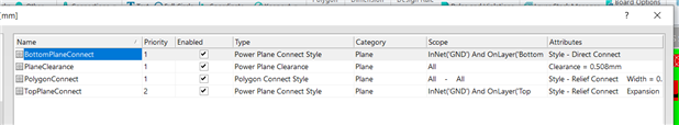

Greetings,
I am looking to have a top plane with Relief Connects and a bottom plane with Direct Connect to the components.  I figured out how to create separate Design Rules and Constraints for the layers, but when I repour the planes, the bottom plane is not following this Constraint Rule and is defaulting to the original Relief Connect rule.
Obviously missing something here - any help is appreciated.

  • bills_alsentis
    bills_alsentis over 6 years ago in reply to tarribred61
    Excellent - thanks Thomas!
    Your solution helped me identify the root cause of my issue - I had created the rule under "Power Plane Connect Style" and not under the "Polygon Connect Style" dialog.  Hence, repouring the planes did nothing as they were not characterized as power planes in the first place.  Using the Polygon Connect Style and Polygon Classes makes sense now....
