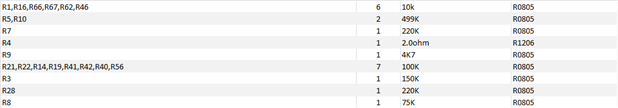

I assemble tens of boards at a time and by hand, probably a hundred or so components on each. Currently I keep my BOM in Excel as I never really use the built in CS BOM management (all values are set though).
So, when it comes to assembling my boards I usually print of part of my BOM (sample below) and run down it that way.....but it's cumbersome. What I would really like is a way of having my deskmounted iPad or 3rd PC monitor to have the layout of the board and I just select a component value and all same components are highlighed and I can just follow the layout. Could be say 1off resistor, but may be 10off.

    I'd liike to help but I don't fully understand your question.  It appears that you are using the built-in BOM function of CS from the attached picture.  Have you tried making your own BOM template and exporting into that template?  It's not difficult if you haven't already used it.

    Had you considered generating a pick-and-place file - the text version is more or less human-readable and gives you the XY coordinates of each component.  It's not quite the graphical tool that I think you're looking for but could be a step in the right direction.  Doing something in c# to draw crosshairs over an image of the PCB would be the work of a couple of hours.

    Or a more manual way would be to use assembly drawings.
    You just draw the outline of the component and place a special string with the designator on the component footprint and export the assembly drawing.
    It should give you what you are looking for. albeit.. only a print. I suppose you could always highlight all the components of a specific value using different colored sharpies.
