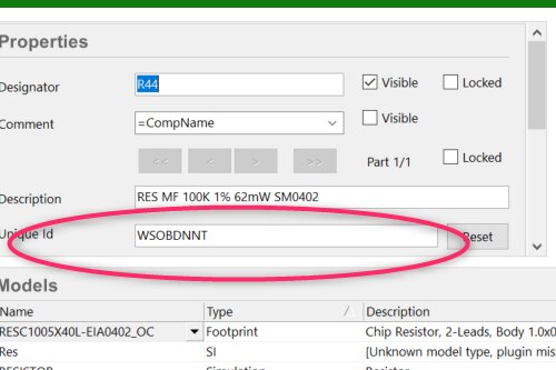

    Instead of deleting the R3 part on the schematic, try to delete it on the PCB, save the PCB and then reupdate from the schematic to the PCB.  You should fix the two unlinked parts.  Linking between the schematic and PCB is done with the unique ID code.  If you mouse doubleclick on a schematic instance of a part you should get the properties box and see a unique id like so..
    If you doubleclick on a corresponding part on the PCB you should get the similar ID code with a leading \ character.  My screen shots don't match because they are different parts.
    In your video, you aborted the linking steps.
