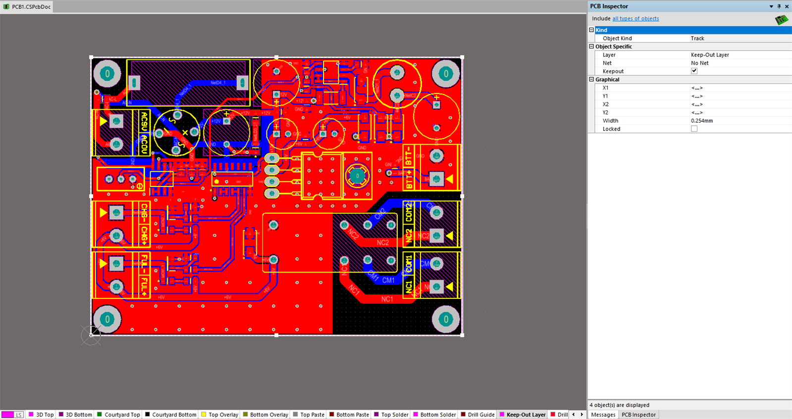

i design pcb and set outline board to keep out layer
but after i gennerate graber dot have outline board on my graber file
i has attach my board to post aslo please help me for try gernarate graber or solve the problam thank you.

    hello,
    I have read in some forum-threads/CS-help-texts about using the keepout-layer as board-limit, however for me it doesn't work.
    I have produced a gerber-output with your file and the *.GKO-file has no real content (you can view it with a simple text-editor).
    My approach for gerber-production:
    I use the outline-layer as board-outline.
    After defining the final board-appearance: Home-ribbon -> create primitives from board shape for outline-layer AND for keepout-layer.
    Both are necessary: outline for the board-edges ; keepout for creation of polygon fills until board-edges
    One anomalyt: A look into your board-file shows: you have most of the 3D-body-models for your devices put into the outline-layer. All Altium-delivered libraries put the 3D-model on the layer 3D_Top or 3DD_Bottom.

    that good solution i can get board outline already thank you for help to solve the problam. image
