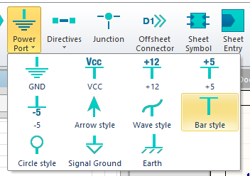

I've seen GND power port and VCC power ports in the Place menu. How do I connect/create other voltage levels and analog grounds. Do I ignore the fact that there may be no symbols for these and just create signal names indicating the potential? Or am I wrong and there actually exist in the vault or a library such other power and ground signals to connect to?

    Just choose a style of bar you want from the power port drop down and place it on the schematic.  Say you choose Bar Style, it'll automatically assign it the net of VCC, then you just double click on it and assign it to whatever net you want.
    You'll then find it's easiest to copy and paste this one you've change the net name on throughout you're schematic.
