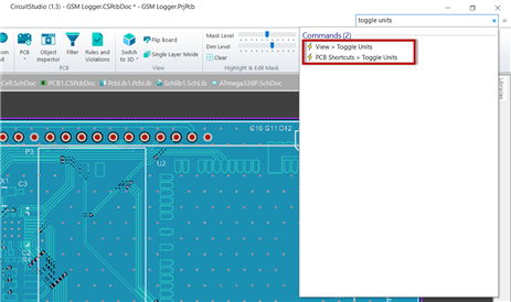

The hotkey Q for toggling between imperial and metric does not seem to be working. Does this work for anyone else?

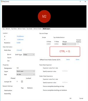

    I am experiencing the same problem, Q does not work to toggle between units, in both Schematics and PCB unlike Altium Designer. However, Ctrl+Q still works to toggle between units when in a properties window:
    As a workaround, you can run "Toggle units" by using the command search on the top right corner:
    Please let me know how this goes, thank you.
