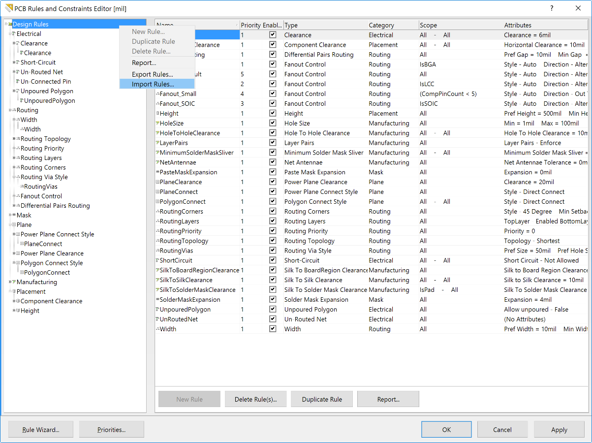

    1. I've never done it, but when you go into the rule wizard you should be able to import rules by right clicking Design Rules and selecting import. Each vendor will have a *.RUL file if they support Altium. image
