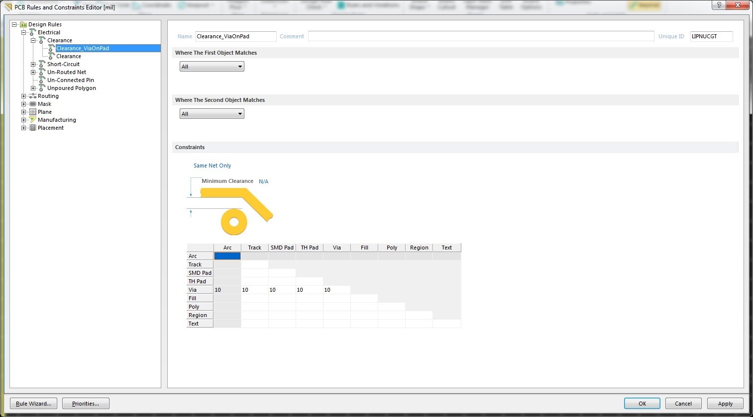

Placing a via over the top of a SMT pad with the same net does not create a design rule error. Is there a way to add a rule prohibiting this?
I tried creating a clearance rule for "same net only" with all the clearance matrix values set to zero except Via-to-SMD Pad and Via-to-TH Pad. Unfortunately, this generates a Via-to-track clearance violation on all vias. I'm assuming zero is not sufficient to disable the matrix connection (e.g., setting Via-to-Track == 0, doesn't disable this clearance check).
Seems like there should be a way to prevent vias over the top of SMD pads. Am I missing something?

    So I've never had an issue with this but suddenly I am questioning all of my previous work.  I have used Altium extensively and it is so easy to create simple rules to avoid placing vias on pads.  CircuitStudio is not quite as simple.  You can still use all of the functionality from Altium by exporting the rules and then writing them as a text file then importing them back in.  Sometimes it's necessary but it sucks.

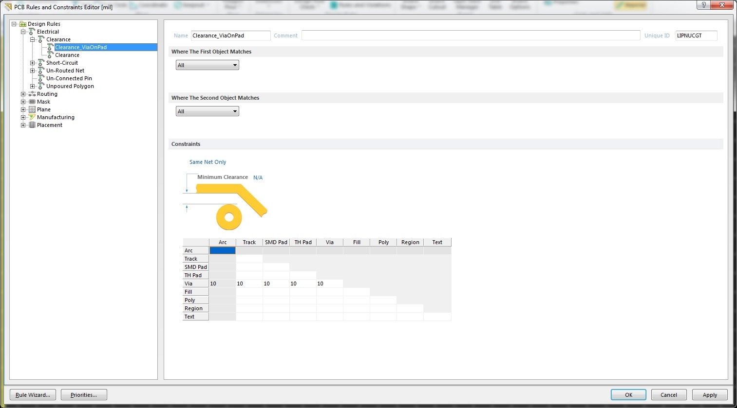

    I did try this and I was able to successfully create a via on pad rule by using the built-in PCB Rules and Constraints Editor.  Right-Click on your screen and select "Design" and then "Rules" and perform the following steps:
    1-Duplicate your clearance rules.
    2-Rename it to something smug.
    3-Change the priority so that it is higher than standard clearance.
    4-Select your first and second object matching if you wish.  I kept them both as "All".
    5-Select "Same Net Only" as your constraints.
    6-Select the Minimum Clearance and change it to -1.  THIS IS YOUR VITAL STEP.  You cannot change each individual clearance to -1.  You must do it as a whole.
    7-Change your clearance for Vias to whatever spacing you want.
    8-Press OK.
  • jallard
    0 jallard over 9 years ago in reply to adamwebber
    Wonderful! Thank you.
    -1 in the Minimum clearance. Seems like something that should be documented. :-)
    This works great, which leads to another issue. Some pads and fills require vias in the middle of the pad, e.g., thermal pads on the bottom of IC's. It would be nice to exclude these from the clearance rule but I don't see a way, since object matching only works for net classes and layers, not pad classes. Unless there's a trick? Maybe -2 in some box somewhere? :-)

    This works if I create a padclass that includes all the pads EXCEPT the pads that I don't want a via-to-pad clearance rule on. This is okay, but it would be nicer to somehow create a rule the excludes certain pads instead of having to include all the pads. Otherwise, I have to remember to update the padclass when new pads are added.
    My procedure is:
    1) Create a Pad class containing all the pads except the pads that I want to allow vias in. (name it "viacheck" or something like this).
    2) Create a clearance rule with "SameNetOnly" and -1 global clearance.
    3) Enter a clearance value in the via-to-SMD pad matrix cell.
    4) Export the rules.
    5) Edit the SCOPE2EXPRESSION value to be "InPadClass('viacheck')". Leave SCOPE1EXPRESSION set to "All".
    6) Import the edited rules.
    This seems to work.
