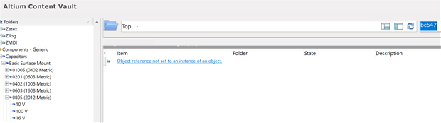

  • alienjack
    0 alienjack over 7 years ago
    Hello Thomas,
    I am also experiencing that issue. I was happy with CS now it’s crashing when I am in the Altium Vault. I am also having another issue with the Altium Content Vault. When I search for a part, in the vault explorer,  I use to get a folder that was titled “All Folders” and the part I was searching for was inside that folder. I would click on the folder, it would open and the part list would appear. For some reason, this folder no longer appears when I do a part search in the vault explorer. Now what I get is a folder that reads, “ Object reference not set to an instance of an object”. I click on the fold, but nothing happens. It doesn’t open. Please see the attached screen shot. Are you experiencing the same issue?
  • e14softwareuk
    0 e14softwareuk over 7 years ago in reply to alienjack
    Quite a few other people are experiencing this object reference error and it doesn't appear to be related to Windows 10 because I have it on my Windows 7 system. There are quite a few other posts on these forums about this issue.
