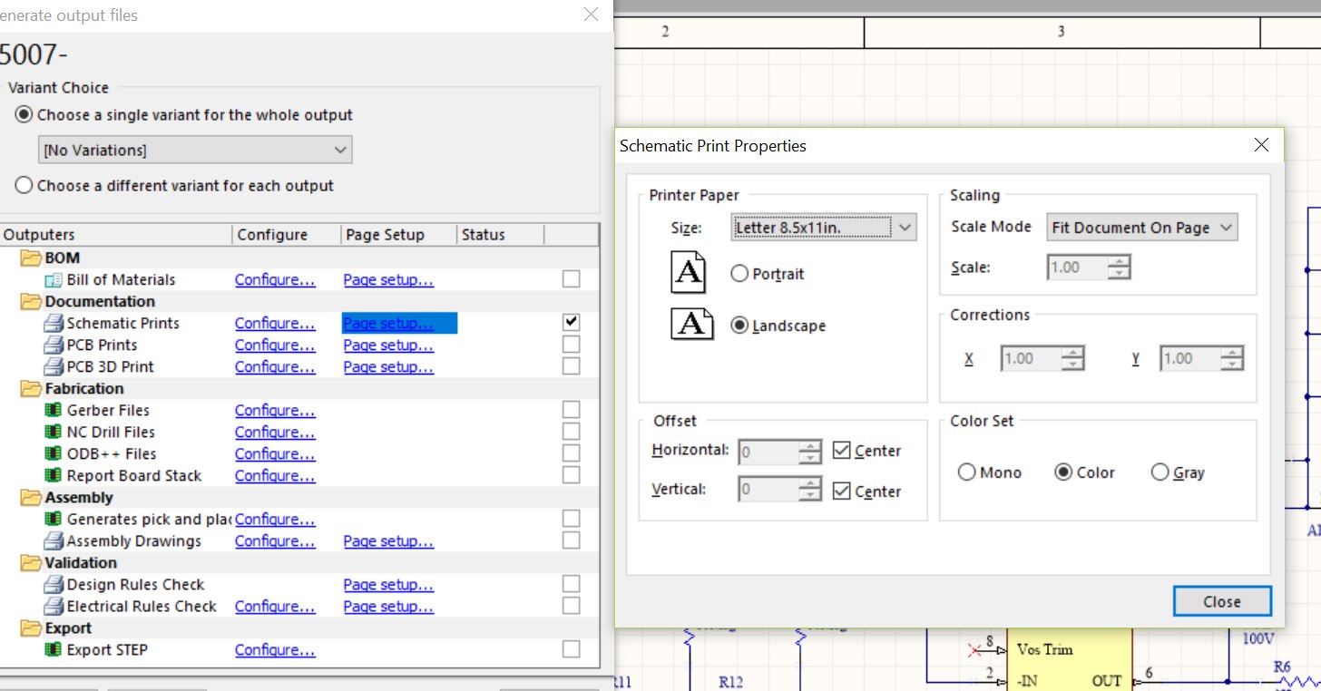

I need to print an 11x17 tabloid schematic.  I have a printer that won't print 11x17, so Altium doesn't offer that sheet size as a printable page in the PDF generator.
I installed CutePDF and can print to an 11x17 pdf output using the print preview option and outputting the page that's open, one page at a time...
The problem is, if I have 6 pages and need them all to come out in one PDF, I want to use the Generate Outputs feature and make a smart PDF...but the Generate Outputs UI is stuck on the HP D110 printer that I have that won't provide an 11x17 size page.
The Generate Outputs UI doesn't seem to be connected to the default printer chosen in Windows, or in the Printer Configuration area in CS.  The page sizes offered in the Page Setup option in the Generate Output Files window always shows what's available from the HP D110 printer, not the CutePDF options.
Tabloid not offered in the pulldown selection, it's stuck on what the D110 offers
