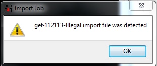

  • optoeng
    0 optoeng over 9 years ago in reply to jlcms
    Yes, I have reported bugs in the ODB++ package output of CS. Uppercase file and folder names must be converted to lower case before opening in ODB++ applications like viewers. Regarding your missing traces: Just send the .STEP files from the STEP output, NOT the ODB++ package. If those are missing the traces, we can be sure that CS fails to add them to the model. Otherwise, the problem could still be with viewing them within an ODB++ package.

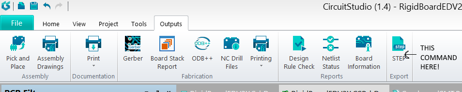

  • jlcms
    0 jlcms over 9 years ago in reply to optoeng
    Here is the step file.
    I don't understand the link between ODB++ and Step file.

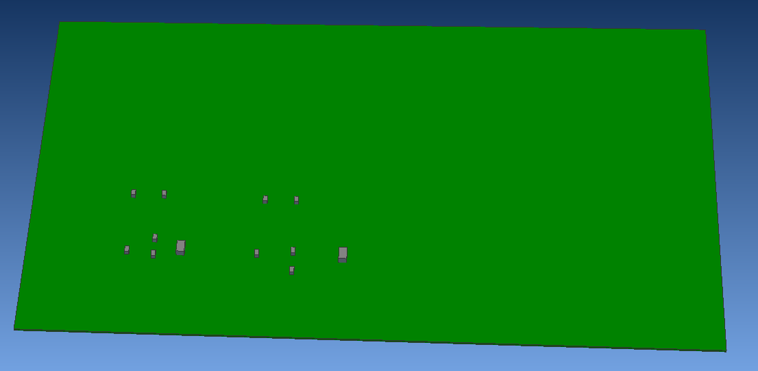

  • optoeng
    Your STEP file has just 13 component bodies on a circuit board object.... no traces:
    ODB++ package includes all CAMfiles created by CS. (At least, it includes all CAMfiles that you specify by configuring 'ODB output'.) This includes pick and place, NC drill, Gerber, Schematic, BOM, and the STEP solid models. .STEP is a solid model format that many CAD apps can import and export. Yes, there is STEP data in the ODB package, but it is compressed and repackaged in a way that makes it difficult to inspect without an ODB viewer. Since I was thinking that your problem COULD be ODB viewer incompatibilities, I suggested looking at the actual non-ODB STEP output. When we do, it also lacks traces.

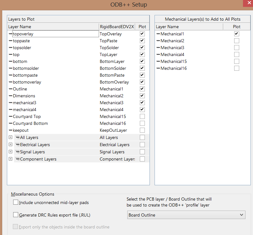

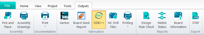

    It looks to me like either, 1) CS fails to include traces in the ODB package and this is a CS bug, OR, 2) You have not configured your ODB output in CS so that traces get included.
  • optoeng
    0 optoeng over 9 years ago in reply to optoeng
    Choose the ODB Output setup on this command bar:
    Here is a typical ODB output setup:
    Be sure to check all the layers used in your layout.
