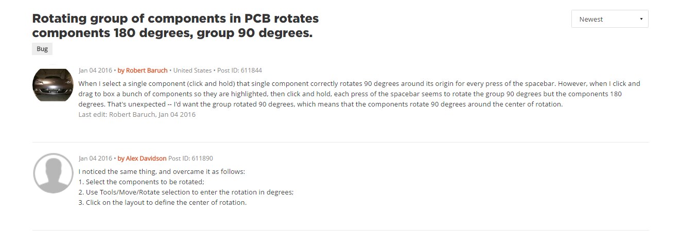

    I tested this a bit more using 45 deg rotation steps.
    I don't know what hitting space bar does but if I do it 8 times then the component group seems to be back full circle.  It seems to be rotating and translating but I don't know what the center of rotation is.
    Some observations:
    Using CTRL+SPACE seems to work fine for me and rotates anti-clockwise.
    Using CTRL+SHIFT+SPACE rotates clockwise.
    Using SHIFT+SPACE does seem to work now.
    When I press SPACE once the parts rotate anti-clockwise and then I have to press SHIFT+SPACE 3 times to rotate clockwise back to the original position.
    My conclusion is that using CTRL+SPACE and SHIFT+SPACE seem to work and using SPACE alone either has a bug or does something that is not intuitive to me.

    There is another older posting about this in the circuitmaker forum..  It perhaps explains somethings.
    https://circuitmaker.com/forum/posts/214678
