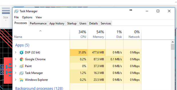

I am having problem while pouring POLYGON, it is taking ages to pour nearly an hour and hangs the Circuitstudio,
This program is using 50 %  of my 8GB memory.
Can anyone help me with this problem ?
It is happening for me since yesterday.

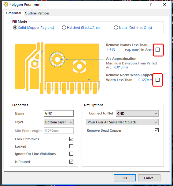

  • yadhu22krish@gmail.com
    0 yadhu22krish@gmail.com over 8 years ago
    I had the same problem.
    I just unticked these options and now its working fine for me. No hang.
