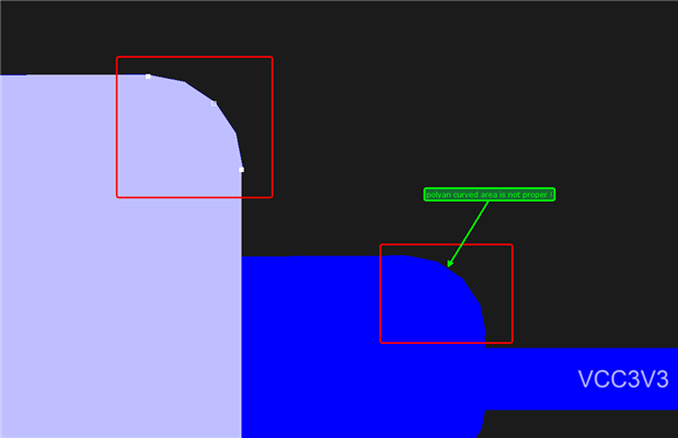

Issues in curved shape polygon pouring, low No of vertices in curved area!
Is there is any option to increase the vertices ?

    Try adjusting the Arc Approximation property of the polygon, this influences how curved edges are drawn.

    Okay Thank You!
