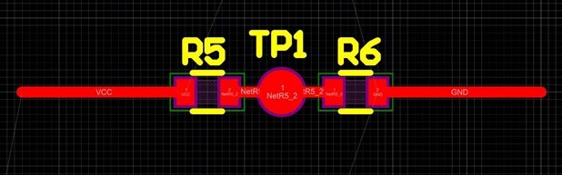

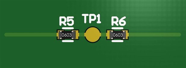

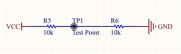

    I create all of my components.  I create all 3D models.  Sure, there are libraries out there that are free and easy to use.  Sometimes I feel like they are improperly created or difficult for some of my designs.  Sometimes I want an extra added feature.  Sometimes the soldermask or overlay isn't what I want.  So after years of using Altium and after purchasing CircuitStudio, I made the decision to make all of my libraries.  It may take a little bit of extra time sometimes.  My theory behind this primarily resides in component selection.  I want to know exactly the size of each component.  I want to know that I am placing the exact component that I want.  Sometimes generic is fine.  In the case of test points, I created my own in multiple shapes and sizes.  I can always add more if I choose.  Library development is a crucial skill to fully understand.  Here are some screenshots:
    RF test points may require a secondary adjacent pad that is ground.  Super easy to make in CS.

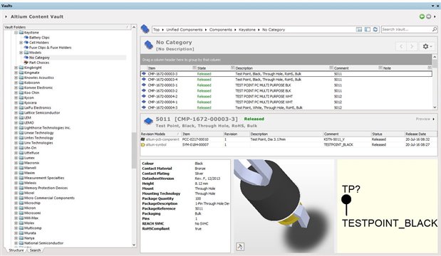

    You can find testpoints like this in Altium Vault ( File - Vault Explorer):
    But, as James said before, component creation is most basic and important part of PCB design. Most of PCB errors are component related, so I also prefer to make my own components.

    Self followup to my original post. Not sure why I didn't find it before, but while looking through Vault for other parts I came across some mounting holes in:
    Board Templates -> Components -> Board Connectors -> Mechanical
    Can't say they result in the correct final thing in a PCB but it has a couple different types so it's a place to start.
  • lamabrew
    0 lamabrew over 8 years ago in reply to lamabrew
    Another self followup for any future Googlers. The mounting holes in the Mechanical section of Vault seem to give the PCB DRC heartache, and I didn't feel like adding rules for just those without understanding them better. They also used tiny screw sizes. So for now just made my own mounting hole components.
    Quite by accident when searching for fiducial components in the stock libraries I came across some test points. I have no idea why my initial search didn't find them. I have had Vault crash several times this week, as well as sometimes it comes up blank for large parts of it and have to quit out and restart. So maybe that played in the failure to find these before (as well as the painful UI on Vault...I hate to complain but I can only describe it  as inexplicable...)
    Here's where to look:
