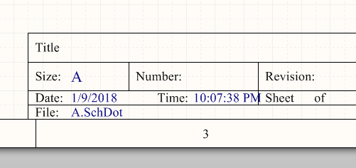

I copied one of the default templates and want to move some of the text fields around that have parameters. I can't figure out how to select them. If I drag a selection box around one it does show up in the SCH inspector, but there's no outline shown (so I have no idea if I've picked the right text box, though I can infer it from the =Parameter text) nor can I figure out how to move it with the mouse. For example here's what it looks like with the text box next to the work Number selected:
Is there a setting somewhere that controls the visibility of the text fields in the templates? I do seem to be able to delete them and then add a new one, but it too becomes invisible. Actual text seems to be fine.

    This does appear to be a bit of a problem. One workaround is to enter some default text for the parameters (Project | Document Options : Parameters), the text will display allowing you to see and edit the position of the parameter.
