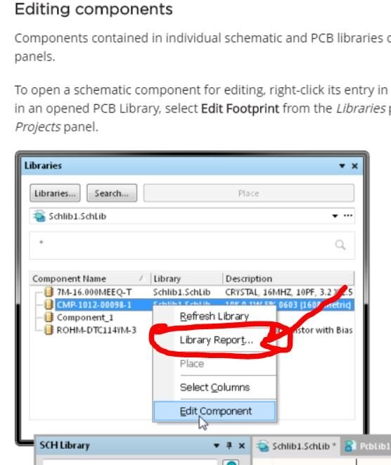

The documentation shows I should get a Library report item in the context menu.
I have the latest 1.4.1.
Did they remove this?
How do I get a list of components in a particular library that I can print out?

    According to the online Docs,  I should get a context menu like below:
    Where is my context menu with "Library Report" item?
  • e14softwareuk
    0 e14softwareuk over 8 years ago in reply to vicelias
    The option you highlight is not available in the current software, the documentation is incorrect.
