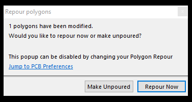

It says there is inside the pop-up itself.  But damned if I can find it anywhere:
  • e14softwareuk
    0 e14softwareuk over 8 years ago
    Hi Tim, the dialog is in error - there is no such option available. Often it can be easier to Polygon Actions > Set All To Unpoured and then Polygon Actions > Set All To Poured later to save having to deal with the popups.

    0 jaza_tom over 8 years ago in reply to e14softwareuk
    Okay thanks for the clarification!
