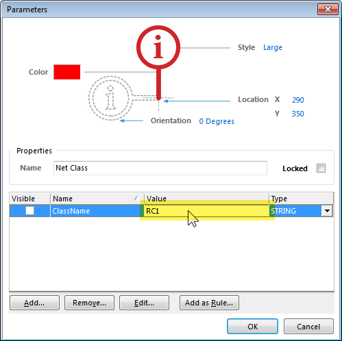

I am trying to learn Circuit Studio and having some trouble using Net Classes. I created a net class and assigned a few nets to it, which works fine. However, when I try to update the schematic with changes from the PCB, it tries to remove the net class that I just assigned. What am I missing? How can I propagate the net classes back to the schematic so it doesn't try to delete them every time?

    The net classes should be added on the schematic using a net class directive.
    Once placed on a net you should edit the properties to give it a name.
    You then update the PCB from the schematic document using Home | Project > Update PCB Document. Although net classes can be defined in the PCB editor they cannot be exported back to the schematic.

    Works. Thanks Peter.
    Would it be appropriate to update this help document to indicate that Net Classes should be added using your method?
    Added Net Classes for PCB | Online Documentation for Altium Products
    ...This is what I was working off of, and had no idea about the Directives thing...
