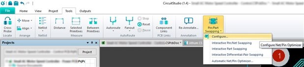

I found the Altium document for configuring Pin Swapping, but can't figure out how to actually SWAP the pins...
I have a simple 2x7 (14-pin) header that I need to swap pins on to clean up the layout...I've configured the pins into pin-swap-groups...I just can't figure out how to actually swap pins that are in the same pin-swap-group. I can obviously just reroute the wiring on the schematic, but I'm hoping this pin swapping thing will simplify the process by keeping both the schematic and the PCB easily readable and just renumbering the pins on the schematic symbol...is that how it works?

    Ok, I figured it out.
    In addition to configuring the pin groups, you also have to configure whether pin swapping is available on which components. This is what I was missing from the above document:
    1) Open the pin swap configuration window
    2) Select the checkbox to enable pin swapping in the PCB editor for the component you are interested in

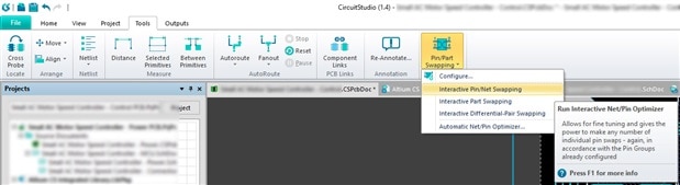

    3) Ensure that any pins that you want to swap are not connected to any traces, then open the Interactive Pin/Net Swapping command from the toolbar:
    4) This will bring you back to the PCB editor with the pins/pads that are swappable highlighted. Click on the first pad, then click on the pad you want to swap it to. Done.
