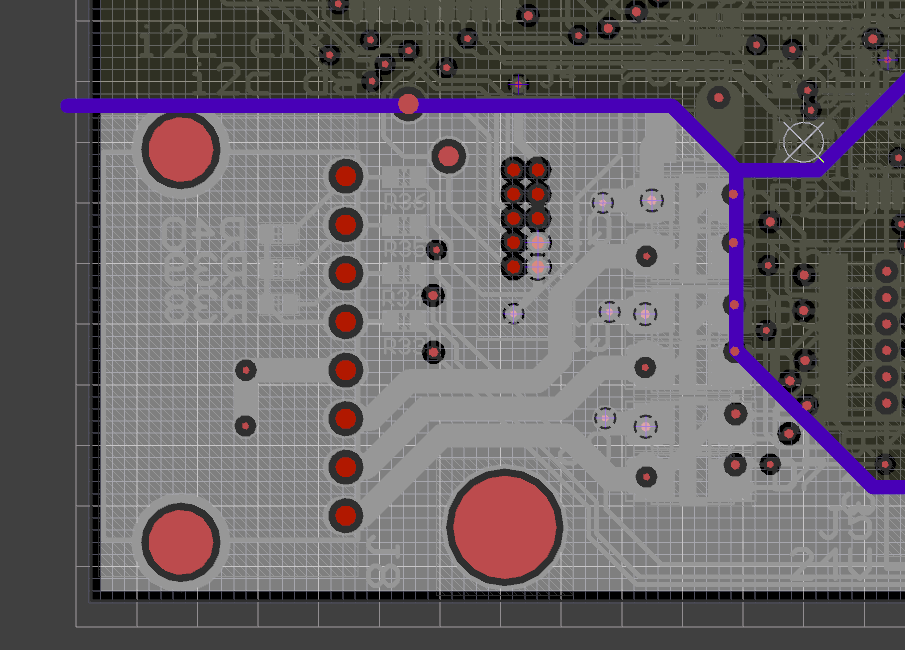

I need my psu, and gnd internal planes to output to gerbers including copper thermal reliefs to vias, and pullbacks where not connected to other vias.
The view of one of my split layers is here.  Looks nice in CS, but the gerber file has none of this information in it!

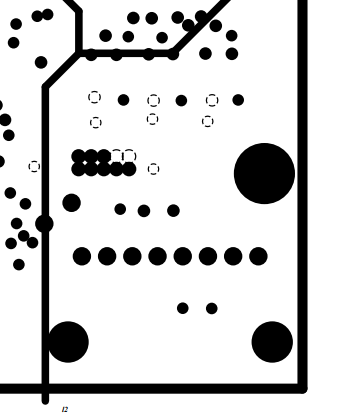

Here's what i get in the gerber.  I dont see any options to change this around; have done a pcb in the past in an older version of CS and did not have this gerber output problem.  Need this one resolved asap

    I got it worked out.  My gerber viewer is old school, and doesn't do PCB apertures.  My PCB vendor's software does read the standard apertures.  here's the result; the issue is resolved.
