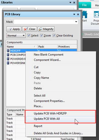

    If you are referring to the ability to right click in the PCB library editor and use the Update PCB function this is still present. Make sure to have your PCB document open.

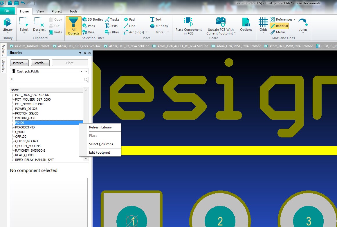

    Yes, this is precisely how I used to do it in v1.4. Now, in v1.5 it doesn't work the same for me. See below:
    The PcbDoc and library editor are open, but when I right click the 0603 footprint in the library, I get the drop down box with just 4 elements, "Refresh Library, Place, Select Columns, and Edit Footprint". I no longer get the option to "Update PCB" as shown in your pic above.

    I can see the confusion - different library windows. The one I was using relates to the view of the parts within a library when the library editor is open. The one you include a screenshot of is for selecting a component from a list of libraries from the PCB editor. This does not seem to have changed from v1.4 so could it be simply a matter of confusion between the two very similar library windows?

    I think I may have discovered the issue:
    I found that if I go to "View/Library" and select the part of interest from the resultant drop-down, that I am then able to "Update PCB" by right-clicking the selected foot print. WARNING, don't select "View/Libraries" (plural) or it won't work. Why would there be a "View/Libraries" (plural) and a "View/Library" (singular)?
