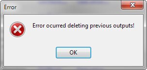

(yes the error message spells it wrong)
In Circuitstudio trying to generate outputs (schematic, PCB, gerber, drill, 3D, etc) immediately returns:
This is about the 4th time this has happened (in 1.4 and 1.5x). Previously I tried some random combination of quit, reboot, directory deletion, etc. and was able to get output. Whatever the magic combination is I can't seem to do it and am stuck trying to release a board. There's no info in messages nor in the project log file about why it thinks it can't generate any output. It just fails.
This time I'm putting the failure here so that if it happens again I can remember the workaround.  I do wonder though that there seems to be limited occurrences of this error (it apparently happened to CircuitMaker users, but no solution is posted there) so wonder if it's got some Windows dependency of some sort (mine is a win 7 system).
Anyone know how to fix this?

    This could be as simple as having a document or file open. CS tries to delete all files and if one is open or locked by the Windows system then it will fail with the error. Although not in relation to CS in the past I have experienced where Windows seems to get stuck thinking a file is open/in-use and only way to clear is to reboot.

    That was my thought too, except I removed the Default Configuration directory so there (should be?) nothing that CS was trying to delete as the directory didn't exist.
    I finally remembered what I did to work around this before: copy the whole project to a temp directory, open it and generate the output(s), and then copy the output directory back.
    I don't doubt that this isn't some sort of windows oddness coming in to play, my annoyance is that the error message is is of no use to help figure out the problem.There's no obvious way to make this error happen, and once "fixed" things seem fine again.

    On a general note that may help others but is probably not related to your situation is to check for hidden files in the output folders. For example if using any sort of version control this can create such files/folders and looking with the normal Windows file explorer they may not be visible with folders appearing empty.

    I encountered that same issue, and here is what I found.
    • There were only 4 files in the output directory and I deleted all but one (Excel BOM that I was actively working with).  The problem continued.
    • I closed the Excel BOM (did not delete it) and was able to then use the Generate Outputs.
    • The output directory (and the BOM) were deleted and a new directory was created.  The generated files were in the new directory.

    My version of the infamous error was due to an integrated library residing on the same folder as the project file.
    To fool Circuit Studio, I moved the integrated library into a sub-folder. Now it generates outputs on the project even with the integrated library open.
    The silly thing is that the compiled integrated library is placed into the Outputs folder, while the project output is placed into Default Configuration\Outputs. So it is not even the same folder...
