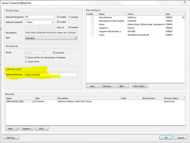

I created a new component by copying the existing one.  New component got the old name plus '_1'. How do I rename it? It's easy in the AD, but I can not find it in CS.

    voltsandjolts over 8 years ago +1 verified
    Screenshot

    voltsandjolts, great thanks!

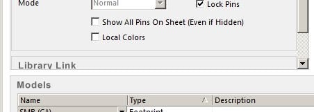

    Magic scrolling:

    0 ahbushnell@hotmail.com over 7 years ago
    I had the same problem.  image
