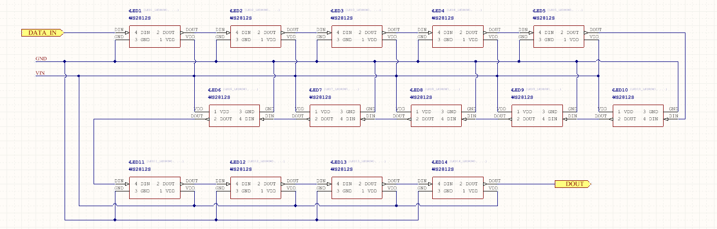

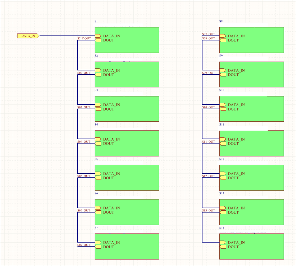

situation is as follows:
S1 contains the controller and basic components for operation
S2 contains a row of 14 NeoPixel LEDs
I'm trying to repeat and connect the LED rows from S2 to form an array of 14 x 14 LEDs.
No matter what I do, I'm facing the problem, The LEDs not being connected, as the nets can not be identified. So all LEDs are floating unconnected on the PCB designer.
Can somebody please give me a hint how this should be build?
Thanks
S2 looks like this
S1 V1 (DOUT not connected, just a desperate try...)
S1 V2 (also not interconnected)
Result in PCB Designer
nothing is connected

    Hi
    I answer it myself:
    The problem was in the PCBlib of the WS2812S, the pins where not named correctly and were not corresponding ot the SCHLib namings.
    This messed everything up.
