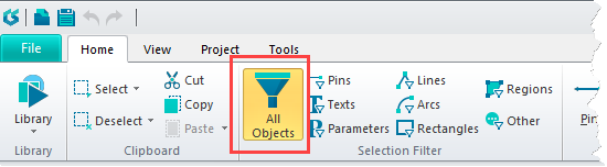

    One thing to check is the object filter - select All Objects so all items should be selectable..
