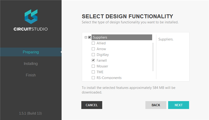

    All of my alternative suppliers have gone missing, leaving me with just Newark and Farnell. I reinstalled. No difference. I had a look in the registry editor and found 2 different structures relating to CS:
    The top one has a bunch of keys for the alternative suppliers:
    While the lower one is missing those keys:
    I made an attempt to copy related keys from one to the other, without success. I will appreciate any help on this problem, which may or may not be related to the OPs question.
  • e14softwareuk
    0 e14softwareuk over 7 years ago in reply to optoeng

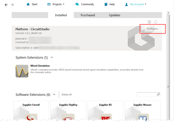

    You most likely have two sets of registry keys because each time you install a new copy of CircuitStudio it uses a different GUID string. During installation there is the option of which suppliers to support - you need to change the default settings if you need all suppliers.
    From My Account > Extensions and Updates you should be able to configure the additional suppliers.

  • optoeng
    0 optoeng over 7 years ago in reply to e14softwareuk
    If I understand you correctly, you are suggesting re-installing and paying careful attention to options presented during the reinstallation. Is that correct?
  • eebylc
    0 eebylc over 7 years ago in reply to optoeng
    No, this is for a separate issue. If suppliers are completely missing from your list this will add them. Digikey Links being broken is a separate issue.
