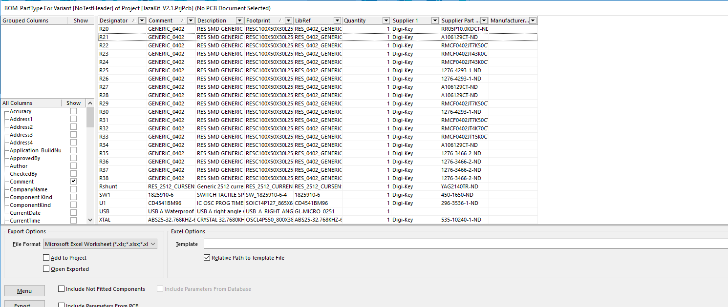

For example, if I want to go through every component and assign unique part numbers for supplier X to each component, I have to manually click on each one.
Is there a way to edit the parameters of the components in a table-like fashion?  Something basically the same as the BOM configuration dialogue box except editable and syncable back to the schematic:
