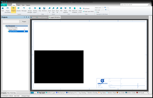

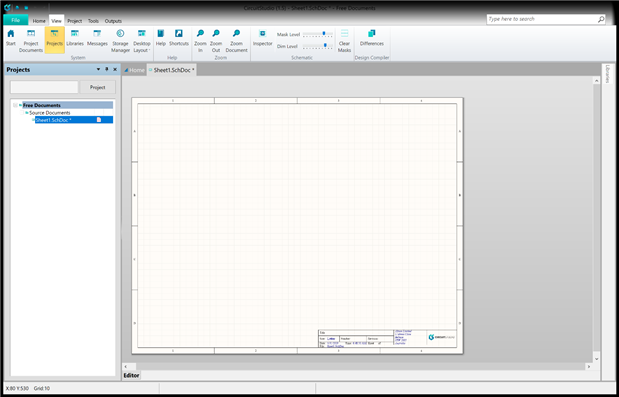

Why can I not change the templates in CS to load my own logo.    I am using the Letter format yet when I load the form form the location noted in C:\Users\Public\Documents\Altium\CS\Templates it is completely different than the one show in CS.  Second when i load the form it has a black square in the center as well as when I load a logo CS lock up completely!
Here is the Version that loads when I create a schematic
Here is version when i load the Letter template.

    Does the following work for you. In the CS template folder (C:\Users\Public\Documents\Altium\CS\Templates) copy Letter.SchDot to MyLetter.SchDot. Open CircuitStudio and then drag the new SchDot file onto the application to edit. You should be able to delete the existing logo and add your own image.

    OK ... Peter I am going to have to pay better attention to the extensions on these files, and how to properly load them into CS.  First the ????.SCHDot files are not accessible from within the File pull down menu/Open Document in CS.  This is what got me into trouble, the only way to get the ????.SCHDot files into CS is by dragging them into CS from a window open in File Explore from Windows.  Once I dragged in my case the file I named Letter-Driver.SCHDot from File Explore into CS I was able to get the changes made I wanted.
    Note once you make the changes to the template one needs to go to there original schematic and right click on the schematic and go under Options, then Document Options to change the default template to the one you just made.
