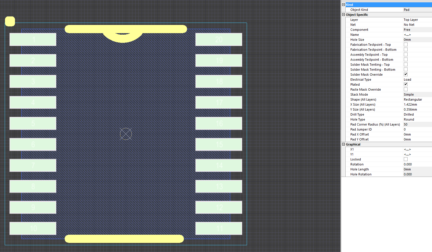

Does CS has a kind of padstacks database as other software have - a centralize place to edit a padstack so that it then can be used in multiple footprints or within a one footprint? Or how is it suppose to edit 64 pins of a singe component (e.g. MCU) when it comes to changes, e.g. increase a size of pad?

    CS doesn't use a padstack database. The closest is to probably have a number of generic footprint variations and then assign to components as needed.

    You can edit multiple pads of one footprint simultaneously with the Inspector (View > Object Inspector)

    Partly works.
    It doesn't have many options that are available in individual property windows for a single pad. E.g. no way to edit paste or mask expansion value.
