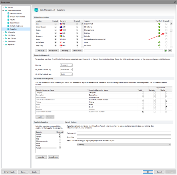

Hallo @ all,

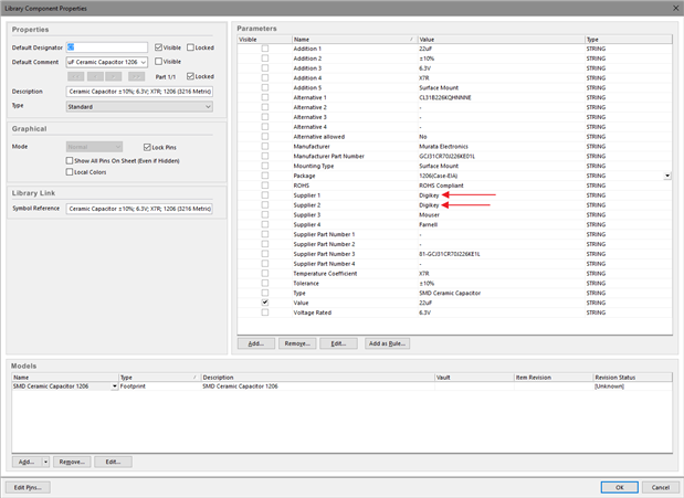

When I open my schematic library (SchLib File) this takes 50 seconds or more. The library contains only 1 component. If I want to edit this takes 50 seconds again. My Supplier ist Digikey. If I remove this Supplier from my Part Parameters the Library open in few second.
If I right-click on the part and select Supplier Link, it will take 50 seconds for the supplier link to open. It is impossible to work with this Version !!!!

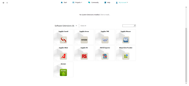

I deleted the Digikey app and use the Altium Part app. In addition, I have entered the access data for Digikey correctly. When I use Part Search, the Digikey search works correctly too. (I use Windows 10 pro 1809)
The description window is emtpy
Here are the circuit Studio Preferences
Here are my instelled apps:
  • joedoe1979
    0 joedoe1979 over 7 years ago

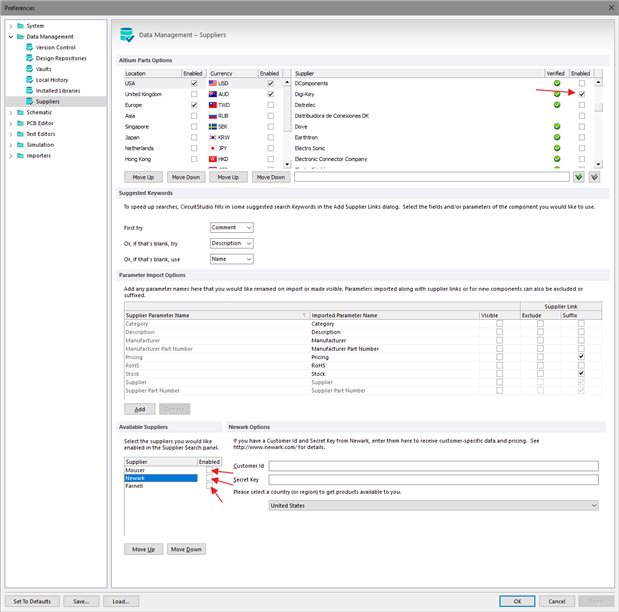

    I found the solution for my problem. I deactivate all supplier and use now only the supplier from Altium Parts.
