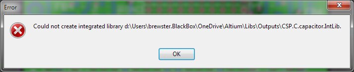

To simplify moving between machines I keep pretty much everything on my Microsoft OneDrive tree.  I recently got around to relocating my libraries and templates.  However this causes a library compile to fail:
Messages console says it worked:
but a check of the file shows its date/time unchanged.

I've googled for issues with OneDrive and Altium but did not find anything.  I checked directory permissions.  All other CS operations work with OneDrive without issue.
Seems unlikely I'm the first person to use OneDrive so I gotta believe there's something simple I've overlooked.  It happens on both my laptop and desktop, both are Win 7 with 1.5.2 CS.

    Is there a way to temporarily disable OneDrive syncing and then give it a try?

    A little further followup - I initially disabled syncing for a few hours. Even though it's now back on the error doesn't normally show any more; I had it happen once more (and a disable sync cleared the error) and that's been it.  Not sure I can explain that but it's not just that syncing was enabled, there must be some other voodoo going on too.
