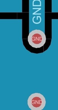

I placed GND copper to Top side like left picture.image
But the copper pour avoids GND Via hole and the trace.
This phenomenon appears everywhere.
In this case, GND via is connected to Bottom side pour.
So it's no problem (electrically),  But it looks bad.
How can I connect directly?
All I can hope is copper pour connect to GND Via hole using three spokes.
Constraints on [Plane]-[Polygon Connect Style] is set to Direct Connect as you see.
This may not be a setting issue.
Please let me know your routing technique.

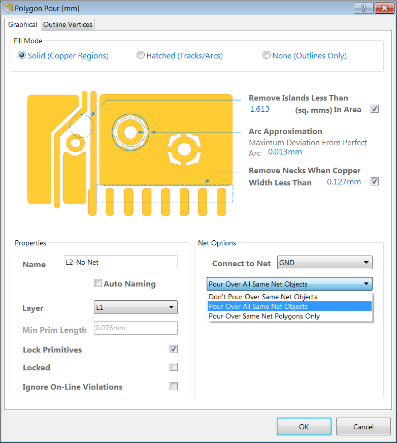

    You may need to select "Pour Over All Same Net Objects" and repour.
  • tyro01
    0 tyro01 over 7 years ago in reply to batuu
    Hello batuu,
    That was a rudimentary oversight. I got the result I wanted.
    My skill has risen a notch. Thanks a lot! image
