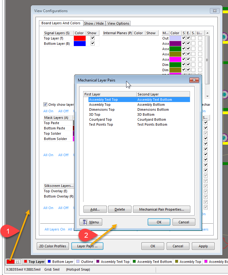

Hi,
I drew parts outline to Assembly Top layer for now.
I thought that parts outline would move automatically to Assembly Bottom layer when place to the Bottom side same as pads.
As  a result, all parts outlines appear in the Assembly Top only. Why is it like this?
tyro
  • tyro01
    0 tyro01 over 7 years ago
    Ok I set Layer Pairs. It does not seem to be reflected automatically.
    I'll replace all bottom side components. This task is a bit annoying...
    Anyway thank you!

    I don't think there should be any need to replace components but worth a try. When you placed components on the bottom side of the PCB did you actually place on bottom or use the flip component to mirror the footprint but still on top side?
  • tyro01
    0 tyro01 over 7 years ago in reply to e14softwareuk
    I used CircuitStudio without setting Layer pairs until just now.
    I always use 'Import Changes From myproject.PrjPcb' and the auto-placement to Top side, and I move parts manually to bottom side using 'L' key.
    I didn't notice about assembly outline conflict that until finished the artwork.
    Anyway, I replaced all bottom parts refer to original Rot/X/Y location.
