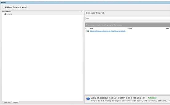

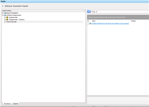

When searching for parts in the vault explorer I am receiving the following result:
"Object reference not set to an instance of an object"
I am using Circuit Studio 1.5.2

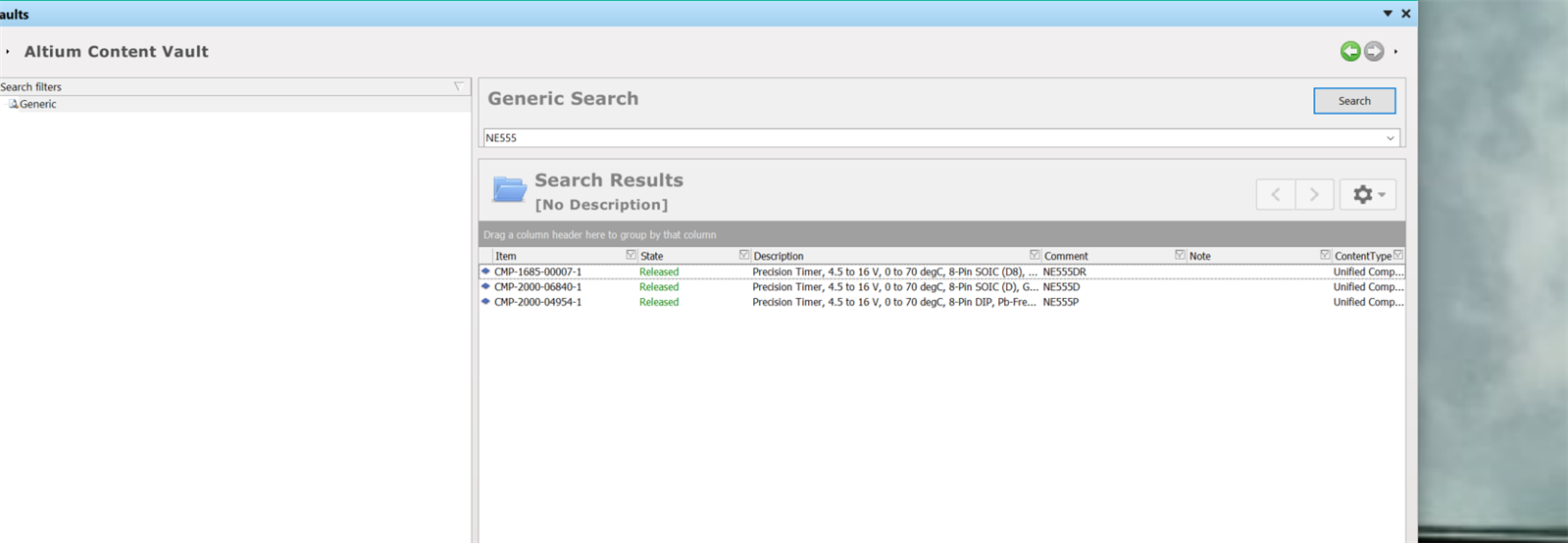

    I was able to get it work in the search tab only after setting the view to "Search Results View". To get this menu to show up I had manually pull up a part out of a folder on the other tab.

  • sshaferdlm
    0 sshaferdlm over 7 years ago
    I have the same issue and both Structure and Search Tabs show - "Object reference not set to an  instance of an object."

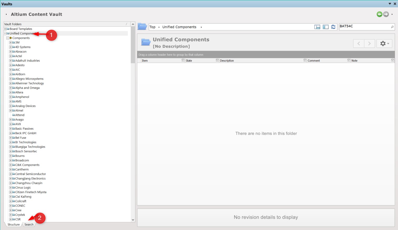

    Hi all,
    I'm hoping this helps.  I found that I can get searching to work for me by doing some steps.  I'll outline what works for me here.

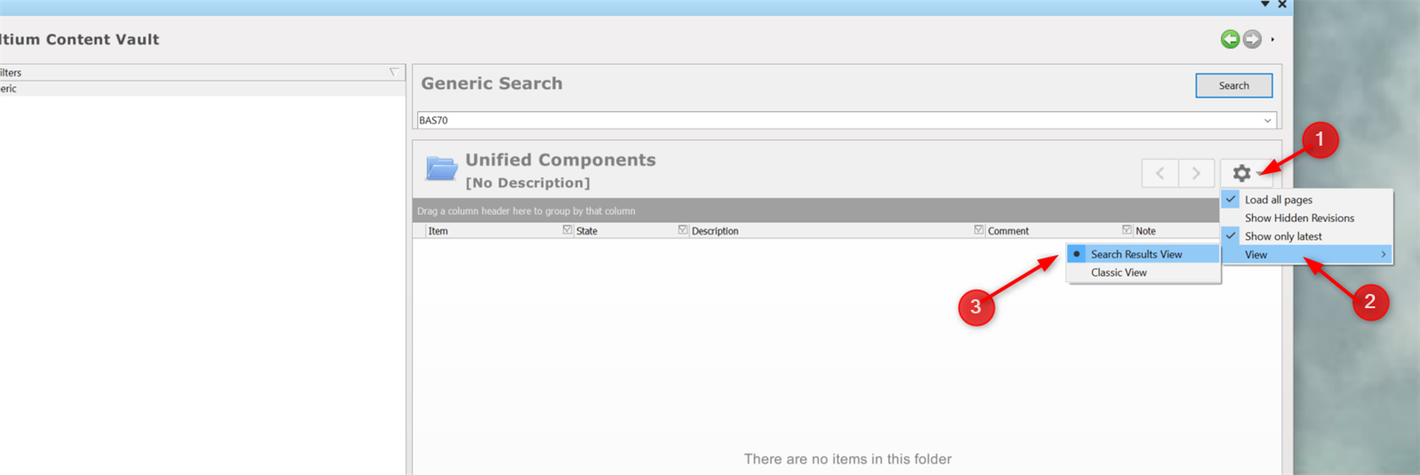

    First start in the Vault page; here it is at the Structure tab.  If you do a failed search it goes to a search results view on the right-hand side with the offending message.  For example; I search on BAT54C and get the error.
    To get back to the previous view, in the left side, scroll back up to the Unified Components line. Then pick the Search tab at the bottom.
    After this, change your view from Classic to Search Mode View.
    After I do this the Vault search seems to retrieve the items properly.
    At least this works for me.

    That is too bad.  I did switch parts so as not to possibly pull back up the same results.  I did searches on other parts such as BAS70, PIC18F and LM7322 with success.  Maybe it will help others or they will find some other setting that is blocking the retrieval.

           I went into systems preferences and disconnected the vault. It gave me an error, which I click OK to send to Altium.
         I then Re - added Altium Content Vault. The regular vault search still has the Object reference error.
    But I tried your steps again and the search as you described was able to find the components.
         Thank you Thomas!!

    0 sshaferdlm over 6 years ago in reply to e14softwareuk
    Thanks Peter,
         Just an FYI the search tab workaround did not work for me at first with just starting and restarting the program, I performed turning on and off the program and my whole machine on and off multiple times with no change.
    What worked - I had to disconnect and reconnect the Altium Content Vault for the search tab to finally start working.

    0 sshaferdlm over 6 years ago in reply to alienjack
    Hey Jack,

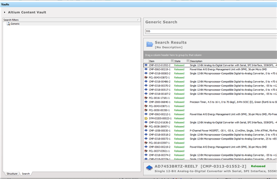

         FYI -  If I do a vault search in the Structure tab, I get the blue ORNSTIAO (Object reference not set to an instance of an object) error. I will get same error when I switch to the Search tab if I do not click on anything else in the structure tab before changing tabs.
    However while I'm in the Structure tab, if i click on any of the folders (which clears the ORNSTIAO error ) and switch to the search tab, the search tab works OK.
    I hope this helps in case you start having problems.
