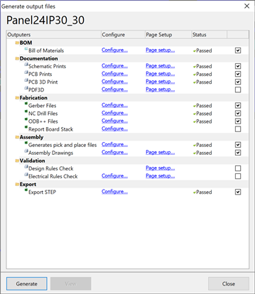

Hi all,
In some project I find that using a normal output generation definition causes the outputs files to be generated in a loop for two or even three times.
As an exampe, with a definition like this, and with no variants.

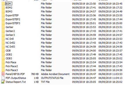

The output folder looks like:
where every output type is produced three times (in this case).
The folder contents are identical apart a slight difference in generation date.
The generation follows this scheme:
First generates all standard outputs, then instead of stopping continue overwriting the main pdv and proceeds generating all xxx2 outputs, and again overwrites once more the main pdf and continue generating the xxx3 folders.

    I have seen an error like this before.  Not exactly the same but I recollect something about it.  But I'm going to start by asking if you've copied and pasted this project or if you have changed the name between revisions? It's possible that your OutJob file is adding the same outputs over and over again when the project is copied or renamed.
    You will get outputs based on the contents of the *.OutJob file.  It's in your project directory.  Open it up with a text editor such as Notepad++.  You should see something like the following for each output that you desire:

    I'm guessing that you are seeing three times the amount of outputs than you want.  They are all listed in order from 1 to whatever.  Maybe 15, I'm not sure.  But you've probably got them up to 45.  The easiest way to remedy this problem is to delete your *.OutJob file and create a new one in the 'Generate Outputs' command.  But I'm a proponent for saving information.  Before you delete it, just move it somewhere else so the project won't access it.  You can always edit the file and delete all the extras but that takes more time.  Unless you've got configurations that you don't want to lose, just get rid of the file.

    I don't fully understand all the details but the command: grep "^OutputType" Panel24IP30.OutJob
    Result in the following:
    OutputType1=BOM_PartType
    OutputType2=Schematic Print
    OutputType3=PCB Print
    OutputType4=PCB 3D Print
    OutputType5=Gerber
    OutputType6=NC Drill
    OutputType7=ODB
    OutputType8=Pick Place
    OutputType9=Assembly
    OutputType10=Design Rules Check
    OutputType11=Electrical Rules Check
    OutputType12=ExportSTEP
    OutputType13=Board Stack Report
    OutputType14=PDF3D
    Does not look like there are repetition of the output types and seems pretty following the Output Configuration dialog.
