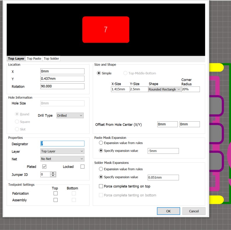

I've had always approached footprints that require complicated paste by setting the paste mask override to some negative number and adding paste pads manually.  However, I found that CircuitStudio (I run version 1.5.2 Build 30) just ignore these paste pads.  When I add the footprint to the PCB the pads are there, but when I save the document, close and reopen CircuitStudio those paste pads are just gone, and the Gerbers generates the same.  So it seems to be a bug in CircuitStudio.  Even if I try to update the footprint, the pads are there, but after save, close and reopen, they're gone.  Has anyone else encountered this?

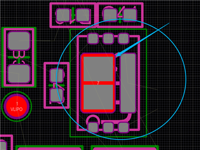

    I have used the same method to modify the paste layers on footprints and have not seen the behavior you report.  For example, I might do this if there is a large exposed pad on a power IC and I want to make the paste stencil into a window pane shape to prevent scoop out of the solder paste. This might appear as below.  The paste layer opening feature is drawn as a fill on top paste and I do not lock it.
    The pad does have a negative value expansion override.
    I have not experienced any problems saving and closing and opening the instantiated part on a PCB design.
    Something to check might be to select the part on the PCB, unlock the primitives and then select the pad that has changed and see if the settings have indeed changed.

    Thanks for your reply.  I see that you use fills.  I placed pads on the paste layer.  If you will, please see what happens if you use paste pads instead of paste fills?  Just to confirm the behaviour please?

    I'm pretty sure you don't want to put a pad on the paste layer.  Use fills, lines, arcs, circles and such but not pads.
    If you want a complicated shape then I suggest making it using a solid region type object and draw the outline. Then select the properties of the region and change kind property to copper and layer to top paste.

    I also used AD for about 8 years and Protel SE99 before that and I did not put pads on anything but an outer copper layer.  Pads are by definition a multilayer object.
    Though I would agree it would be better if the software prevented you from putting pads on other layers or at least gave a warning.  Others can correct me if I am wrong.

    When adding pads only on past layer in my component.
    They disappear after "repour all" operation.
    Then I open the component .pcblib -> view -> library -> right click on component name -> update PCB and get back my custom thermal pad design.
    But I have to be very careful before sending gerber to manufacturer so in my point of view this is a bug that should be fixed.
