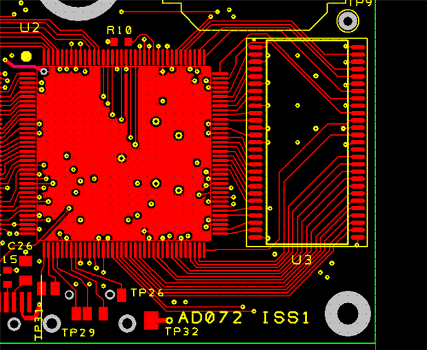

    You do not need matched length traces to interface SDRAM to a micro with an SDRAM controller at modest speeds. I have not done this for an STM32H723 but I have on several occasions with FPGAs.
    Keep the tracks short and as direct as possible. Don't try and run it flat out at maximum speed.
    I have not studied the STM32H723 in detail but it looks as if you should have no trouble reducing the SDRAM clock to well below 100MHz shoudl you wish to.
    The picture shows an SDRAM in TTSOP package connected to an FPGA in TQFP144. Careful selection of FPGA pins allows the whole thing to be routed on one layer with no attempt at track length matching. This layout would work with 100MHz SDRAM clock , although in the actual design it ran at 25MHz to save power.
