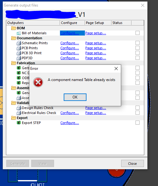

I experienced a strange problem during BOM generation in Circuit Studio v.1.5.2.
Please see attached pic. This behaviour happen only in two of my projects. Have anyone a suggestion for me?

    Try getting rid of the .OutJob file in the project directory (back it up somewhere first) so that CS is forced to create a new one when you press Configure.

    Hi, thx for the suggestion.
    I tried multiple times but the problem remain. Is it possible that the bug came from the PCB file that was originally exported from Altium to CS?

    OK, didn't realise that the project wasn't created in CS but was imported from Altium. The PCB file shouldn't really affect the BOM unless the 'Include Parameters from PCB' option is ticked, but you're not getting that far. Everything else is OK, DRC/ERC and it all compiles?
